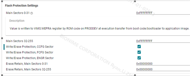

How to keep CCFG when we issue erase command in bootloader mode?
We have checked below in syscfg but seems the CCFG still erased...

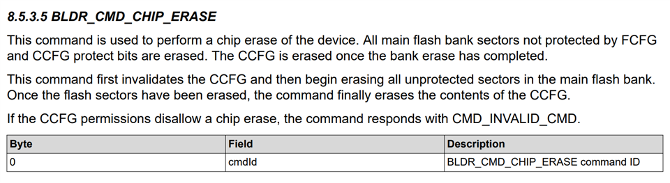

Hi Aichi,
You are viewing SysConfig Device Configuration runtime protections. The bootloader chip erase command will erase the CCFG:
https://www.ti.com/lit/swcu193
