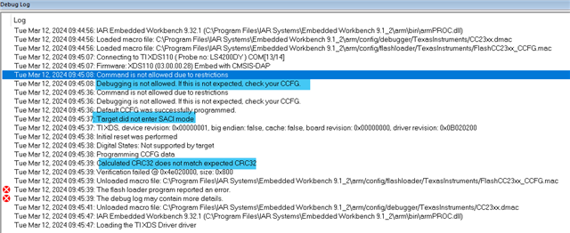

I can't Download & Debug cc2340R5 with IAR

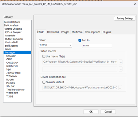

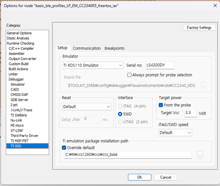

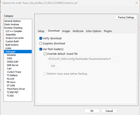

I tried changing various option settings, but it did not connect.
IAR ver: v9.32.2
example code: basic_ble_profiles

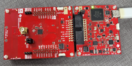

HW: LP-XDS110ET + LP-EM Launchpad
this is error Log

  • ThakI checked revision of LP-EM-CC2340R5 is A (1.0). and I have custom board with Revision B(2.0). But both throw the same error.

  • I received a new Lanchpad(Rev.B) today but still occurred same error.

  • Hi ari,
    Thank you for the update.  I have been able to replicate your issue and recommend that you try using IAR v9.50.2 instead as I was able to correctly start a program and debug session using this version.  Be sure to delete your prior workspace and create a new one before importing and building the project.  I have been informed that the F3 SDK v7.40 was only tested with this version of IAR and as such, listing IAR v9.32.1 in the Release Notes may have been an error.  I apologize for the confusion and appreciate your patience as this environment dependency is resolved.
