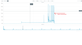

    Let me explain,
    I have a sensor which is connected to BLE CC2340R5 and it sends an interrupt periodically(10s) to wakeup BLE from standby.
    And also, sends data 'x' to the BLE through I2C.
    Now at BLE side, I want to advertise this data 'x' 7 times and then put BLE to standby state until next interrupt occurs(After 10s).
    Please check below current waveform so you could understand better how I want the advertisement to happen.
    This is not working within the interrupt code.
    So, I wanted to understand more about advertising in this way.
    Hope you understood.
    Rushikesh.

  • Hello Clement,
    Its not that I want to use 7 advertising sets I just want to advertise  the same data 7 times.
    I've tried both the solutions(using 7 advertising sets and 1 adv set repeating multiple times) but its not working.
    Also, I'm verifying it through a sniffer tool and the device's current measurement tool where I get current spikes of advertisement.
    Please check above attached image of the waveform for the same.
    Rushikesh.
    Are the wave-forms quoted below the ones you were referring to? What are the results you are getting now?

    5.Yes, the waveforms are the one which I should get on advertising within interrupt code.
