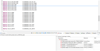

I am trying to read Temperature values continuously for CC2640R2DK_CXS.
I have imported the project i2ctmp_CC2640R2_LAUNCHXL.
Please guide me with clear further steps on how to make i2ctmp_CC2640R2_LAUNCHXL project work for CC2640R2DK_CXS.

    I had already followed the above steps and created custom board files by cpoying CC2640R2DK_CXS and following the rest of the procedure.
    The problem is the Board file for CC2640R2_LAUNCHXL has the below defined for i2c
    Where else these definitions are missing in the board files for CC2640R2DK_CXS
    Please check the board files for CC2640R2_LAUNCHXL and CC2640R2DK_CXS from your side
    Let me know what needs to be in this case inorder to continuously read Teamperature values- with CC2640R2DK_CXS

  • This is due to the RSM package having a reduced number of GPIOs, thus only certain peripherals can be defined at any time.  Create CC2640R2DK_CXS.c/h equivalents of CC2640R2_LAUNCHXL_I2C0 from the CC2640R2_LAUNCHXL.c/h files.  Make sure that you are using valid RSM GPIO pins which do not overlap with any other board functions.
