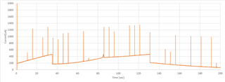

After powering the LP-EM-CC2340R5, the charge current? shown in the image was observed.
The image shows operation at -40°C and 3 V.
This current is particularly noticeable at low temperatures and it takes longer for the current to subside.
Our application is intended to be powered by a coin cell battery, and we do not want this kind of current to occur many times, so
 -What is the mechanism of this current?
 -What are the reasons why this current becomes apparent at low temperatures?
 -Is there a case in which this current is expected to occur many times after power-on?
 -What methods, if any, can be used to reduce this current?
