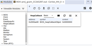

    To me the issue on your first test was the fact the Total Free Size keeps growing - even over the Total Heap Size value. When using ICall_malloc, are you still facing the same issue?
    If yes, could you please use the ROV to check if it provides the same values? (use the "heap" section of the ROV, see here for details on the ROV https://software-dl.ti.com/simplelink/esd/simplelink_cc13xx_cc26xx_sdk/7.10.00.98/exports/docs/ble5stack/ble_user_guide/html/ble-stack-5.x-guide/debugging-index.html?highlight=icall_heapstats_t#ti-rtos-object-viewer)
    The issue causing the allocation to fail is actually kind of expected as the Largest Free Size is smaller than the space you attempt to allocate. We can discuss ways to address this last element, but I would prefer we address the other issue first.
  • Hi
    yeah . We are facing the issue even with the function which you have suggested
    Are you asking the below setting while the issue is occuring?
  • In that case the context value is not changing.
    Am I following the correct thing which you are expecting?

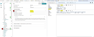

    May I ask if HeapMem is enabled? It does not seem to be the case. I would like to suggest you to enable it so you can have more debug information.
    Here are the steps:
    1- Open SysConfig > TI RTOS > BIOS > Default Heap Settings and set "Default Memory Heap Type" to "HeapMem". Set HeapSize to 0x16E00 (~93808).
    2- Build and flash the code
    3- You should have a new view in ROV called "HeapMem"
    4- Run your program again and monitor the values in "HeapMem" both in the "Detailled" and "FreeList" views
    Here is what it should look like:

    Before that can you tell us where the stack and heap is being configured?
