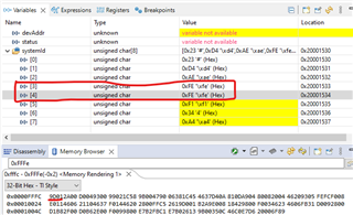

System ID in app_dev_info.c->DevInfo_start, as the code, it's consists with BLE address, set middle bytes with 0xFFFE value.
memcpy( &systemId[0], &devAddr[0], 3 ); // use 6 bytes of device address for 8 bytes of system ID value
memset( &systemId[3], 0xFFFE, 2 ); // set middle bytes to 0xFFFE
memcpy( &systemId[5], &devAddr[3], 3 ); // shift three bytes up
But both systemId[3] and systemId[4] equal 0xFE, not equal to value in 0xFFFE.
That's not make sense, can you explain details about this?

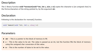

    If I may, your usage of memset is not correct as the second parameter is cast as a 1-byte char.
    Your code should be:
    systemId[3] = 0xFF; // set middle bytes to 0xFFFE
    systemId[4] = 0xFE; // set middle bytes to 0xFFFE
    I hope this will help,

    I am afraid this is not correct, please refer to the definition of the memset function I have shared in my previous answer.
    Assuming you want to copy the data from an address, you should used the memcpy function, but I don't think it make sense copying some random parts of the code into the systemId.

    Yes, the code memset( &systemId[3], 0xFFFE, 2 ); will set systemId[3] and systemId[4] to 0xFE, and through the comments, seems it's right on your reply

    You should patch the code as following:
