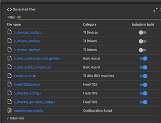

I need configure a POCI Pin as PIN_UNSIGNED. Is it possible to do that using SysConfig???

I hope you are doing well. While I do not think there is an automatic way to set POCI as unassigned, you may be able to set them manually:
-You would want to first reference the syscfg version of ti_drivers_config.c, then make a local copy (in your project) of ti_devices_config.c ti_drivers_config.c and ti_drivers_config.h. Next exclude those three files from syscfg automatic generation, and finally locate the POCI pin and set it to GPIO_CFG_NO_DIR.

I think is mandatory to add a pin to .pociPin of SPICC26X2DMA_HWAttrs instance.
.pociPin = PIN_UNSIGNED, but PIN_UNSIGNED does not exist . What should I put instead of??
