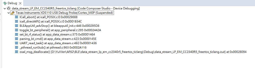

When I invoked BLEAppUtil_advStop() to stop peripheral, the system would stock in abort() loop.
Here's the call stack:
So, how can I actually toggle (start/stop) peripheral mode?

  • Hello Zach,
    Thanks for reaching out.
    Could you please point out how (where in the code) are you calling the BLEAppUtil_advStart() and BLEAppUtil_advStop() functions?
    For example, this is how it is being used inside the app_peripheral.c in Peripheral_GAPConnEventHandler() to enable advertising until the amount of new formed connections has been reached.

  • Hi David,
        Our implementation receives a set of commands from UART and then invokes specific functions based on those commands.
    Regarding this problem, the function 'toggle_bt_peripheral()' is performed when the relevant command arrives.
    This function toggles the peripheral mode:
    bStatus_t toggle_bt_peripheral(int on) {
        if (on && !is_bt_peripheral_enable) {  // When peripheral mode is disabled
            return BLEAppUtil_advStart(peripheralAdvHandle_1, &advSetStartParamsSet_1);
        } else if (!on && is_bt_peripheral_enable) {  // When peripheral mode is enabled
            return BLEAppUtil_advStop(peripheralAdvHandle_1);
        return SUCCESS;
    However, each time the system invokes toggle_bt_peripheral(), it gets stuck in an abort() loop.

  • Hello Zach,
    Understood.
    Where/How are you calling the toggle_bt_peripheral() function? Is it inside the UART callback function?
    Based on your next answer, I would suggest using BLEAppUtil_invokeFunctionNoData() to invoke the toggling function. This function receives a callback and data and switches the context in order to call the callback from the BLE App Util module context.

  • Hi David,
        First, we create a thread to read data from the UART:

    When the data matches our built-in commands, it triggers the related behavior. In the context of this issue, toggle_bt_peripheral() will be invoked.
    By the way, should I use BLEAppUtil_invokeFunction() instead of BLEAppUtil_invokeFunctionNoData() ?
    Since the function takes one argument.
    Zach
  • Hi David,
    Update information:
    Below is a pseudo code :
    static int set_bt_rf_status(int flag) {
        int status = 0;
        int tmp;
    #if defined( HOST_CONFIG ) && ( HOST_CONFIG & ( PERIPHERAL_CFG ) )
        tmp = flag & 0x4;
        if ((status = BLEAppUtil_invokeFunction((InvokeFromBLEAppUtilContext_t)toggle_bt_peripheral, (char*)&tmp)) != SUCCESS) {
            return status;
    #endif
        return status;
    Is my understanding correct?
    Zach
  • Hello Zach,
    If your variable is a global one, then you can use the BLEAppUtil_invokeFunctionNoData().
    After trying this (not sure if it is the first or second code-snippet), do you still get the error?
    BR,
    David.
  • Hi David,
        Thanks for your response. The problem has been solved, but I'm also curious about the mechanism behind it.
    Can you explain why this solution works or where can I find related documentation regarding the TI BLE Stack?
    Many thanks,
    Zach
  • Hello Zach,
    Sure thing. This function changes the context in order to call the callback function (toggle_bt_peripheral in your case) from the BLE App Util module context where you can actually use BLEAppUtil_advStart() and BLEAppUtil_advStop() functions.
    Hope this helps.
    David.
