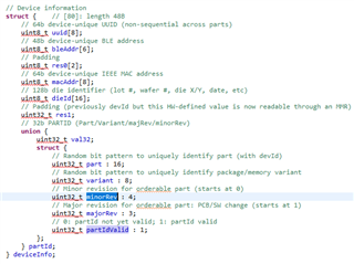

In hw_fcfg.h, the deviceInfo struct as this:
I have two questions:
1. As comments the majorRev default value should be 1, but I read out 0.
2. These elements are readonly, How can I change the value.

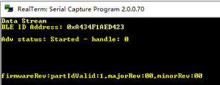

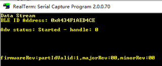

Hi David,
I used two boards to check this, they have the same result.
sprintf(firmwareRev, "partIdValid:%d,majorRev:%02d,minorRev:%02d", fcfg->deviceInfo.partId.partIdValid, fcfg->deviceInfo.partId.majorRev, fcfg->deviceInfo.partId.minorRev); MenuModule_printf(APP_MENU_PROFILE_STATUS_LINE1, 0, "firmwareRev:%s", firmwareRev);
