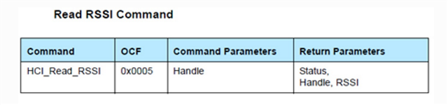

- after the delay i read the rssi using the function HCI_ReadRssiCmd().
the rssi return always 0. i tried different frequency and all the same, i also add a command at the beginning of the code to increase the RX gain  but it did not help (HCI_EXT_SetRxGainCmd(HCI_EXT_RX_GAIN_HIGH);)
