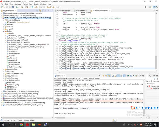

  • I can produce the .out with the CCFG,but I cann't get the .bin file with the CCFG.How to convert the executable (.out) to binary format (.bin) with CCFG?
  • Hi, Clément:
    Thanks for you help, now we can build the second .out file and it works well .But we want burn it via JLINK,we need .BIN file.Would you please tell me how to build .bin file.Thanke you very much.
    James
    2024.03.30
  • Hi, Clément:
     I modified the makefile as shown below
    buttonled_LP_EM_CC2340R5_freertos_ticlang.bin: buttonled_LP_EM_CC2340R5_freertos_ticlang_WITH_CCFG_CRC.out
    @echo 'Building secondary target: "$@"'
    @echo 'Invoking: Arm Hex Utility'
    "C:/ti/ccs1260/ccs/tools/compiler/ti-cgt-armllvm_3.2.1.LTS/bin/tiarmhex.exe" --diag_wrap=off --binary -o "buttonled_LP_EM_CC2340R5_freertos_ticlang_WITH_CCFG_CRC.bin" "buttonled_LP_EM_CC2340R5_freertos_ticlang_WITH_CCFG_CRC.out"
    @echo 'Finished building secondary target: "$@"'
    @echo ' '
    @$(MAKE) --no-print-directory post-build
    I can get a .bin file ,but it don't work , could you please guide me .thankes!
