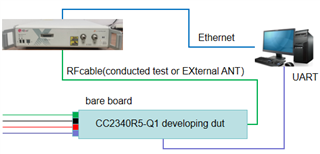

    We are designing  CC2340R5-Q1 to a bluetooth board, Now we are meeting some problems.
    As we all know, for RF performence testing, we usually use UART to send/ recieve HCI cmd with Project named host_test_LP_EM_CC2340R5_freertos_ticlang.

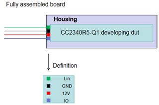

    And this CC2340R5-Q1 poroject is going to NPI. So We really need your help with How to test RF performence with Fully assembled boards when there is only Lin interface.
   Here is our Fully structured flowchart:
  The bare board which is assembled with housing even with Glue-pouring, therefore there is only LIN/ Power-12V/ GND/ IO outside.
  So we wanna to ask you if there any source code which allow us to send/ recieve HCI cmd by LIN interface? Or you have other better advertisement for Fully assembled board RF testing? IQXel-80 is our test instrument, and it only can indentify HCI cmd now.
   Need you help very much and hope for your reply, thanks!
   Annie
  • Hi Annie,
