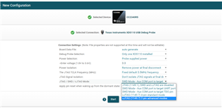

  • Hi Ryan, thanks for your reply and for detailing the importance of the nRST. On our design we we have included it and intend to use it however on a batch of samples we got, there is an issue with connecting to the nRST which is currently making programming these samples not possible. I just thought it was worth asking if there was a temp workaround if we only have access to VDD, GND, SWDIO and SWDCK. Uniflash does seem to allow for a manual Chip Erase but the response back is not clear if it was successful or not, this is what I see:
    [4/2/2024, 8:32:22 PM] [INFO] Cortex_M0P: Flash loader: CC23xx_CC27xx_FLASH_LIBRARY_VERSION 3.18.0.5
    I noticed when setting up session in Uniflash there is options to select different connection settings, under the JTAG/SWD/cJTAG Mode: there is an option for cJTAG 2 pin advanced mode. Is this something that can be used?
  • The message shown is the only one that arises during a successful manual Chip Erase.  You can perform a Blank Check to determine whether it was successful.
    The CC2340R5 does not have any cJTAG, only SWD. so this is not an option.   Note that cJTAG on the CC13XX / CC26XX devices also requires a RST pin connection for programming.
