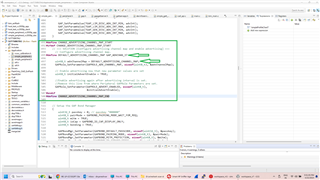

  • hello Arther,
    can you please help me to set manufacturer specific data in cc2650 so that i can connect CC1352P7 to it
    I have changed the code and now able to connect to the BLE peripheral CC2650.

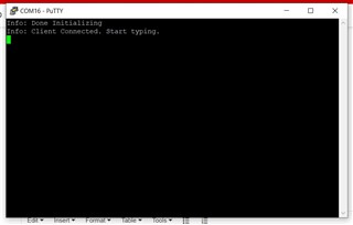

    Now, I am getting this on Terminal,
    but I dont see anything printed on terminal window when I type.

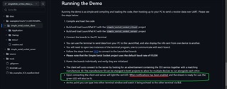

    I think as per the readme on github, i need to enable the notification.
    Please help me with this.
    thank you,
    Dnyaneshvar Salve
    The data inputted in the terminal won't be displayed. Only the data received by the device over BLE will be displayed.

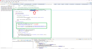

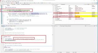

  • Hi,                                   (10 April 2024, 01:30 IST)
    i think CC1352 is able to find the service UUID but some conditions in code are not met.
    as per the screenshot,
    in function uint32_t SimpleServiceDiscovery_discoverService(uint16_t connHandle, ICall_EntityID entity,
    simpleService_t *service, gattMsgEvent_t *pMsg)
    in Case,
    case BLE_DISC_STATE_SVC:
    // Service found, store handles
    if (pMsg->method == ATT_FIND_BY_TYPE_VALUE_RSP &&
    pMsg->msg.findByTypeValueRsp.numInfo > 0)
    service->startHandle = ATT_ATTR_HANDLE(pMsg->msg.findByTypeValueRsp.pHandlesInfo, 0);
    service->endHandle = ATT_GRP_END_HANDLE(pMsg->msg.findByTypeValueRsp.pHandlesInfo, 0);
    // char * uart_msg_str = "Service found, store handles\n\r";
    // UART2_write(uartHandle, uart_msg_str, strlen(uart_msg_str), NULL);
    this "if" condition is not being satisfied.
    and control directly try to exit the function with last line
    return retVal;

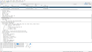

  • Hi Marie H,
    Pleas see the attached image for sniffer log of BLE connection.
  • Also I followed the instruction on https://software-dl.ti.com/lprf/simplelink_academy/modules/ble_01_basic/ble_01_basic.html and scanned for the attribute table of CC2650. Attching the screenshot for more inforamtion.

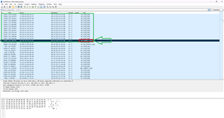

  • Hello Marie H,
    Thank you for your help.
    I have set the CC2650 to advertise on channel no 37 as per the instructions given in provided link and also verified that CC2650 uses channel no 37 to advertise it data using the sniffer.
    Yes, sniffer by default uses the channel no. 37.
    There is no change in the sniffer results.
    I even tried to connect the CC2650 (BLE peripheral) with LightBlue android application and sent some data to CC2650.
    But came to know that I don't get any sniffer information after both BLE central and peripheral gets connected to each other.
    attaching the screenshot.
    in screenshot after the connection, there is is no information about the BLE communication between this ble devices after connection is established.
    I am sending a personal message containing the whole sniffer log for details.
    May be the sniffer is not capturing the data after BLE connection is established.
    (We have many ble devices (CC2650 and other) in office and I dont see none of them exchanging data on sniffer log, only ADV and SCAN RSP)

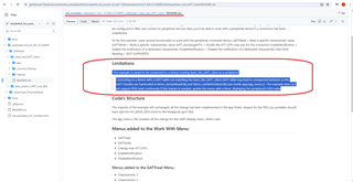

    Apart from this I wanted to share some information with you.
    On the below link of github, there is a note about limitation of project.
    It about different project CC2340R5 (SDK7.40). link given below,
    https://github.com/TexasInstruments/ble_examples/blob/simplelink_low_power_f3_sdk-7.40/examples/rtos/LP_EM_CC2340R5/ble5stack/basic_ble_GATT_client/README.md .
    But when i tried to co-relate it with my current problem and came to know about the initialized structure variable streamServiceHandle with .numChars = 2, in file simple_serial_socket_client.c (screenshot attached).
    But in my BLE peripheral application it has 21 characteristics.
    This structure is used in
    Function uint32_t SimpleServiceDiscovery_discoverService(uint16_t connHandle, ICall_EntityID entity,
    in file simple_service_discovery.c for service discovery related functions.
    Does this has anything related to my problem?

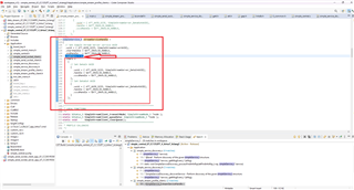

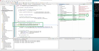

  • Hello Marie H,
    I have update.
    I took reference of Project "simple_central_LP_CC1352P7_4_tirtos7_ticlang".
    and made some changes in simple_service_discovery.c file. (16 bit UUID is required instead of 128 bit)
    As I changed service->uuid.uuid, to uuid and service->uuid.len to ATT_BT_UUID_SIZE.
    I started to discover simple service successfully.
    (Please refer the screenshot attached).
    But still when I type something on console, i am not receiving anything on BLE peripheral side (CC2650)
    regards,
    Dnyaneshvar Salve
