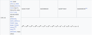

     What the Polynome of CC2340R5-Q1 ROM Serial Bootloader used?  we are developing the programming for this chip using BSL, but can't find the CRC32 polynome for BLDR_CMD_CRC32 command.

    The polynome used for the BLDR_CMD_CRC32 is seen below:
    CRC32 Polynome
    The polynomial is used to pre generate the CRC32 value in a look up table. Please refer to the Fast Computation section of the CRC32 readme. Additionally, I have linked the CRC32 readme below for further reading.
    CRC32 Readme
