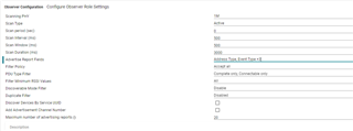

  • Hello, I have some new discoveries, I checked this part of.syscfg, it can appear datalen, but still no pdata

    Could you please provide a bit more information about where you are reading the advertisement report (a code snipped of the function where you are handling this could be helpful if it is possible to share).
    Have you included the BLEAPPUTIL_ADV_REPORT as part as your centralScanHandler?
    I would suggest looking into our material here: Bluetooth Low Energy Scanning and Advertising.
    I can also share an e2e thread that shows the required setup to read the advertisement report: https://e2e.ti.com/support/wireless-connectivity/bluetooth-group/bluetooth/f/bluetooth-forum/1278585/cc2340r5-central-to-peripheral-automatically-connect

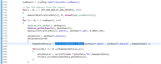

  • BLEAppUtil_EventHandler_t ttcScanHandler =
        .handlerType    = BLEAPPUTIL_GAP_SCAN_TYPE,
        .pEventHandler  = ttc_ScanEventHandler,
        .eventMask      = BLEAPPUTIL_SCAN_ENABLED  |
                          BLEAPPUTIL_SCAN_DISABLED |
    void ttc_ScanEventHandler(uint32 event, BLEAppUtil_msgHdr_t *pMsgData)
        BLEAppUtil_ScanEventData_t *scanMsg = (BLEAppUtil_ScanEventData_t *)pMsgData;
        switch (event)
            case BLEAPPUTIL_ADV_REPORT:
            }break;
            case BLEAPPUTIL_SCAN_ENABLED:
            }break;
            case BLEAPPUTIL_SCAN_DISABLED:
                uint8_t reason;
                uint8_t numReport;
                uint8_t i;
                uint8_t len;
                uint8_t *pBuffData;
                uint8_t pOutData[100];
                uint8_t pOutDataLen;
                uint8_t test_write[6]={0xff,0xff,0xff,0xff,0xff,0xff};
                uint16_t device_nameLen;
                reason = scanMsg->pBuf->pScanDis.reason;
                numReport = scanMsg->pBuf->pScanDis.numReport;
                // Get the address from the report
                for(i = 0; i < APP_MAX_NUM_OF_ADV_REPORTS; i++)
                    memset(&centralScanRes[i], 0, sizeof(App_scanResults));
                for (i = 0; i < scanMsg->pBuf->pScanDis.numReport; i++)
                    GapScan_Evt_AdvRpt_t advReport;
                    GapScan_getAdvReport(i, &advReport);
                    memcpy(centralScanRes[i].address, advReport.addr, B_ADDR_LEN);
                    advdatalen = advReport.dataLen;
                    if(advdatalen>0)
                       NamepOutDataLen = parse_bleAdvData_ToName(advReport.pData , advdatalen , NamepOutData );
                       for(uint8_t j = 0 ;j<NamepOutDataLen;j++)
                           pOutDataLen = sprintf((char *)pOutData,"%02x",NamepOutData);
                            ttcUart_writeData(pOutData,pOutDataLen);
                    pOutDataLen = sprintf((char *)pOutData," Rssi:%d , address:%02x%02x%02x%02x%02x%02x\r\n",
                                                                                      advReport.rssi,
                                                                                      centralScanRes[i].address[0],
                                                                                      centralScanRes[i].address[1],
                                                                                      centralScanRes[i].address[2],
                                                                                      centralScanRes[i].address[3],
                                                                                      centralScanRes[i].address[4],
                                                                                      centralScanRes[i].address[5]);
                if(!ttcBle.waitConnFlag)
                    BLEAppUtil_scanStart(&ttcScanStartParams);
            }break;
            default:
            }break;

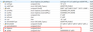

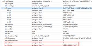

    My expectation is to output the RSSI and mac address of the peripheral (both of which I have implemented), as well as the name of the peripheral, which is what the function parse_bleAdvData_ToName does, but at the moment advReport.pData has no data and I can't parse it
    As a sanity check, could you please trying the process inside the BLEAPPUTIL_ADV_REPORT case?
    BR,
    David.
