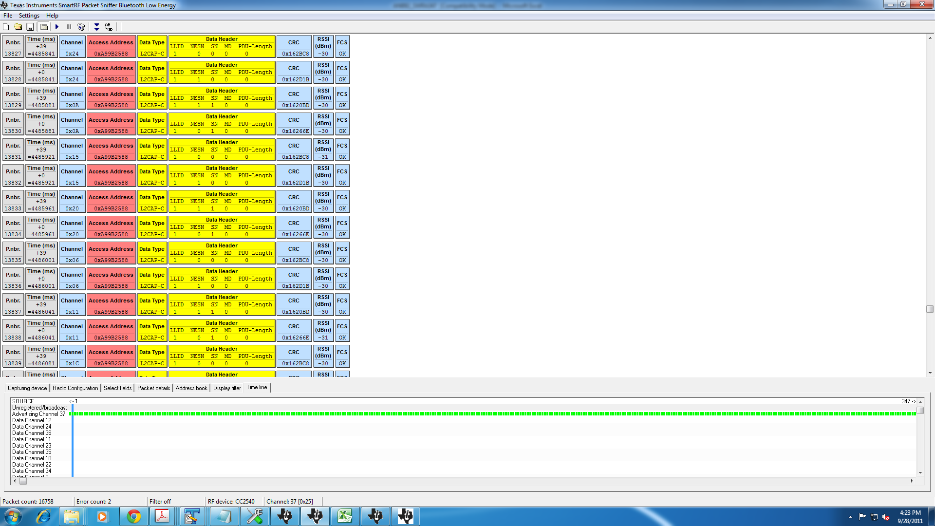

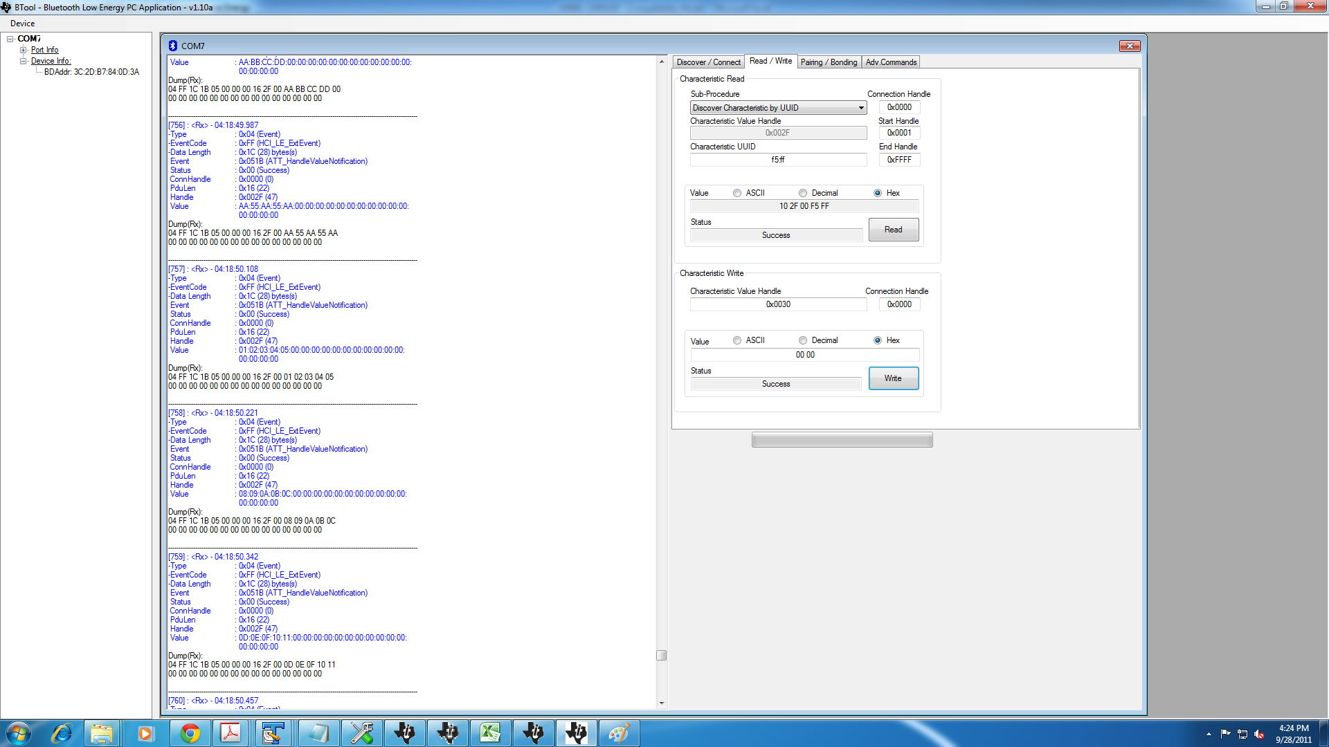

  • Hello All,
    I could get the Sniffer running and below are the snaps from Sniffer and Btool., I am having hard time decoding the " Time (ms)" field but I believe, its giving me relative timings of each packet., And since my notification interval is 40ms, I am assuming that +39 (or sometimes +40) in the " Time (ms)"  corresponds to this., However, if you see the same value captured in the Btool, which captures as per the computer's time, the spacing between 2 notifications is ~100 ms.,
    Can any one comment on this please? (Also kindly let me know if my understanding is correct about the " Time (ms)"  of sniffer.,)

  • Hi Nagaraj,
    This is good, now we have something to analyze. First of all, you can see that the connection interval is right, because of the 40ms shown in the sniffer log. What is not shown are the actual notifications. What we see in that sniffer log is only the empty event packets which are sent to maintain the connection, these are not shown in BTool. Could you save the entire log and post that instead so we might look at the actual notifications, because it is those that are interesting.
    The notification is usually triggered when a change is made in the characteristic value, is this something you have control over?
    Regarding that the sniffer sometimes miss the connection is because it only listens on one advertisement channel (of three possible), so if the connection is established on another channel than the sniffed one, it will miss the frequency hopping scheme hence miss the connection establishment. It is a 33 % chance, have patience or use three sniffers on three channels.
    We are getting closer.

  • Hello Nick,
    So finally, I am able to capture the data again., Attached the entire log from sniffer., Since I had made the connection interval 100 ms, I am seeing +99 ms in sniffer log., So I believe I am not missing anything., Let me know your comments.,
    Thanks and best regards,
    Nagaraj Hegde7127.100 ms connection interval.psd
  • And here is the log for 40 ms interval., I am much relieved now., Thanks so much NICK !!!!
