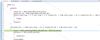

I create a thread for UART, but after I finished writing the code, I tested it and found that it would display like this
  • Hello Ryan Li,
    I hope you are doing well. Looks like CCS tried to open a file location that did not exist ( ... + 0x9de), could you detail to me how to setup your thread in the code?

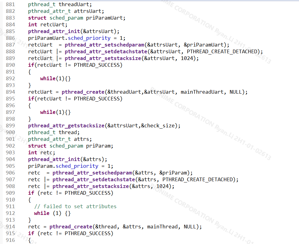

  • I created two threads and moved the exact same Code to another thread. In Debug mode, pressing F6 (Step Over) can continue execution, but if I switch to pressing F5 (Step Into), the same situation will occur.
    I set my thread as shown below
    Or is it that my thread stack size is full, causing this to happen?
    As shown below, when I execute this step, the error on the right will pop up.

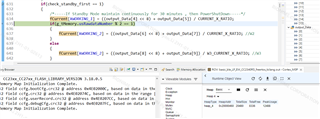

  • I check the status of the Memory usage as show below
  • Hello Ryan,
    Taking a look at your memory usage:
    -While the flash is little large it is not completely full, could you expand the "FLASH" section to see if any Indvidual array is overfilled?
    - - The other parameters in memory usage look fine (NVS and CCFG are supposed to be at 100 %).
    The heap also looks ok, as long as it does not exceed the set size.
    As a test, does the program work as expect (minus the functionally that we need to change/remove) if the if satement that contains the badly behaving code is changed or removed?

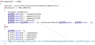

  • Hello Alex ,
    I try to use the previous version of the project I wrote myself. This version has been tested and does not throw out the error message that the file location cannot be found when debugging.
    When I added the new version of the project content to the previous version step by step, I found the following situation
    When I add this line of code, a message that the file location cannot be found pops up. After removing it, it works normally again.
    g_tFFF1.pData[g_tFFF1.ucLen - 1] = Checksum_GetResult(g_tFFF1.pData , g_tFFF1.ucLen - 1);
    But I don’t think this is the root cause, because as shown in the picture, I also added the exact same Code above but there was no problem.
    So I did another test, I added the code above, and then I set the BreakPoint in two places, as shown in the picture below
    (1)The BreakPoint set in  judgment of if will also show that the file location cannot be found.
    (2)But I set BreakPoint in the if judgment, but it can be interrupted successfully, and the file location cannot be found will not pop up.
    Does this confirm that CCS has optimized certain codes during compilation? As a result, the file location cannot be found when debugging, and the breakpoint cannot be set?
    Or is there a problem when the IDE builds to .out?

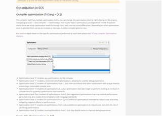

  • Hello Ryan,
    Yes it might be a good idea to try the new CCS (12.5 or newer) and the new SDK (7.40), with dependences that updated as well!
    A good item to look into for further reference is the following webpage about CCS documentation: 7. Debug — Code Composer Studio 12.7.0 Documentation
    -The breakpoint section has some extra useful information pertaining to this thread.
    -And it does seem like the optimizer can affect breakpoints following the statement from the picture:
    Alex F
