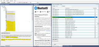

  • Hi @RogelioD,
    We are facing multiple issues, The majority of multiple test cases come under the  A2DP/SNK/AVP/ section.
    Are you referring to the A2DP_ICS document for Table numbers and items?
    I am attaching the screen capture of the PTS suite here.
    From the setup we use for ICS testing, I am not directly able to list the test cases as you say by table and row directly, test cases are the combination of what is listed in the table as I understand.
    you can see the description of the failures written on the screen.
    All tests that come under the AVP section are failing. The reason is the device is not responding to SRC with unsupported type/format etc.
    I would suggest you to refer the following document for the details of the failure.
    Bluetooth SIG A2DP_TS (A2DP Testcases).
    This document is in sync with the ICS failure ID.
    Thanks!
