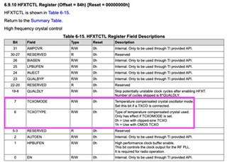

1) How to connect ?  TCXO output should be connected to X48P and X48N should be open , right?
2) SW setting?  I found TCXOTYPE register setting in HFXTCTL Register. This bit should be set accordingly to the TCXO output type, CMOS or clipped-sine, right?

    1) That is the correct connection scheme. Our device supports
    2) That is correct. Also, there are two other bits on this same register that need to be set: TCXOMODE and EN
    One important aspect, though: at this time I see no formal software support for TCXO, which should be configured in the Sysconfig --> Device Configuration module. In this case, please inform your customer this procedure is not thoroughly validated yet.

  • Hello Rafael,
    Also, you mentioned customer should set EN, is that bit0?
    So , totally, customer should set TCXOMODE= bit7, TCXOTYPE = bit6 and EN= bit0?
    Yes, these three bits have to be properly configured and set.
    I reiterate that we do not have official support for TCXO in our SDK at this time, thus please inform your customer to use it at their own risk.
