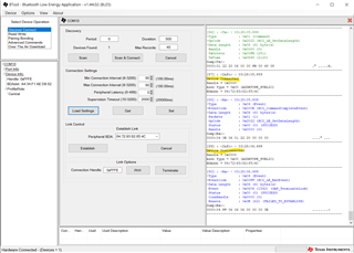

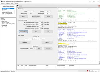

    It will dissconnect sometime using two launchpads as well. Below is a screenshot of the disconnection.

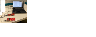

    FuYu did test with two TI EVM at their office environment. The fail rate (disconnect happen immediately after connecting) is around (1/20 ~ 2/20, they did two runs. Each run test 20 times connection). Could you comment if this fail rate is normal or not at office environment ?
    Test environment:
      SDK version: simplelink_lowpower_f3_sdk_7_40_00_64
      Central : CC2340R5 launchpad + host_test FW _ BTool
      Peripheral: CC2340R5 launchpad + basic_ble FW
    Test result:

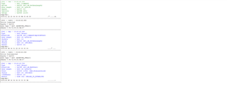

    Disconnection log:
    It is possible that this may be expected if the environment has a very large amount of BLE traffic and lots of RF activity. The failed to establish error occurs when the central fails to hear back from the peripheral within the first six connection events during connection establishment. If the environment is very busy, then its possible environment interference may be causing connection to miss packets. It would be helpful to see the disconnection reason for the peripheral as well.

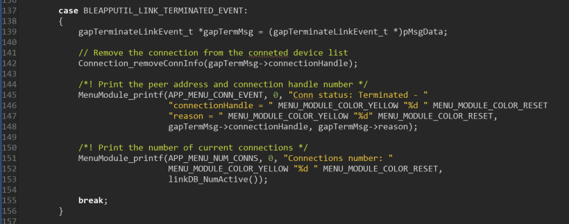

  • Hi Jerry,
    The disconnection reason may be extracted within the BLEAPPUTIL_LINK_TERMINATED_EVENT case inside the app_connection.c file. The disconnection reason may be found within the gapTermMsg->reason
