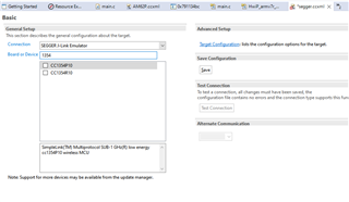

Currently we are using CC2674P10, can we use Segger Jlink for flashing or debugging with Code composer studio ide or Uniflash.
Hello prathmesh,
Segger J-Link should be supported with CCS 12.7 for the CC1354 and CC2674.
The CC1354P10 may be easily migrated to the CC2674P10 by referencing the Running Software Examples on the CC13x4 or CC26x4 section of the User's Guide, but this should concern code/project more than the programmer/debugger settings. Uniflash v8.6 is synced with CCS v12.6 so please further verify whether it supports Segger J-Link for this device.
