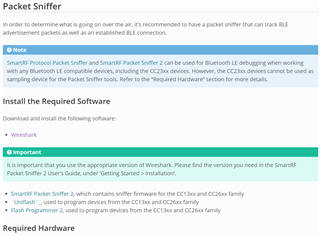

How to capture and display BLE packets.

Please refer to the Packet Sniffer section of the debugging guide: Debugging — SimpleLink CC23xx SDK BLE5-Stack User's Guide 3.02.04.00 documentation
You also need the PACKET-SNIFFER-2 (PACKET-SNIFFER Calculation tool | TI.com) Tool which require an export approval.

The CC2340 EVM cannot be configured as sniffer. You can instead use a LAUNCHXL-CC26X2R1 , LP-CC2652R7, or LAUNCHXL-CC1352R1.
Using the EVM mentioned allows to track Bluetooth LE compliant traffic, including traffic from/to a CC2340.

The procedure is described here: https://dev.ti.com/tirex/explore/content/simplelink_cc13xx_cc26xx_sdk_7_40_00_77/docs/ble5stack/ble_user_guide/html/ble-stack-5.x-guide/debugging-index.html#packet-sniffer
For further questions related on the usage of Packet Sniffer with CC26X2R1, please open a new thread.
