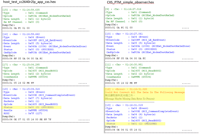

We have enabled PTM in simple oberserver, and test 8 hci commands. But its fail to read RSSI by HCI_ReadRssiCmd.
We issue "HCIExt_ModemTestRxCmd" first then try to get RSSI, success in host test, fail in observer example, PTM mode.
Any idea to fix it?
    If I may, it seems the RSSI returned in the host_test case is also incorrect (0x7F) - which may be indicating no packet was received.
    PTM does not enable all the commands. Among others, the HCI_ReadRSSI() command is not enabled in PTM mode.
    I hope this will help,
