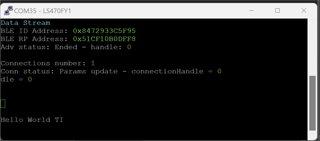

    The only observation that I can say you is that removing the uart MenuModule_printf the issue takes a little bit more time to happen, around 5seconds more.
    With regards
    Thank you for confirming that the issue is present in different connection intervals. We have recently released the 8.10 SDK. Can you re-test on the new SDK? There were several improvements and fixes made to the BLE5 Stack that may have an impact on the behavior you are seeing. Some of these may be seen here: https://software-dl.ti.com/simplelink/esd/simplelink_lowpower_f3_sdk/8.10.00.55/exports/docs/ble5stack/release_notes_ble5stack_3_03_01_00.html

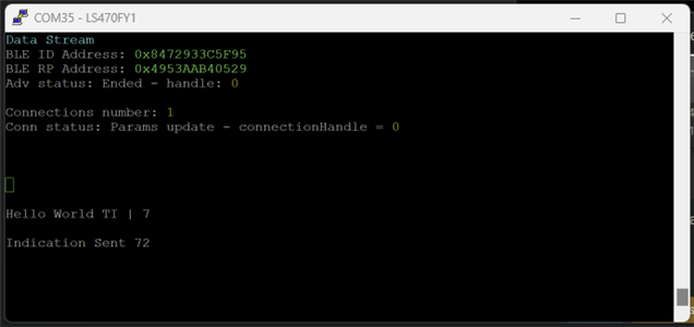

    Just for your information, If I don't send any indication and I just receive WRITE WITHOUT RESPONSE everything is working correctly.
    But If I send indications while I receive WRITE WITHOUT RESPONSE messages, then problem appears again.

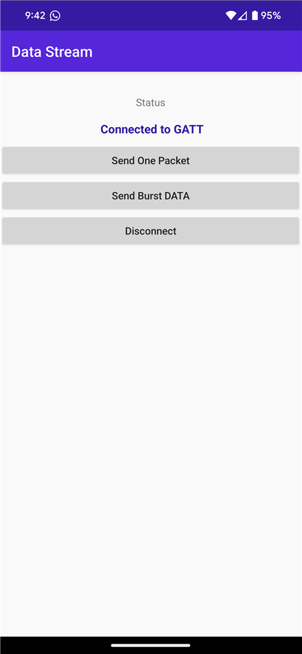

    Thank you for verifying this on the new SDK! I have tested using your custom application and I believe I am seeing the same behavior you are.

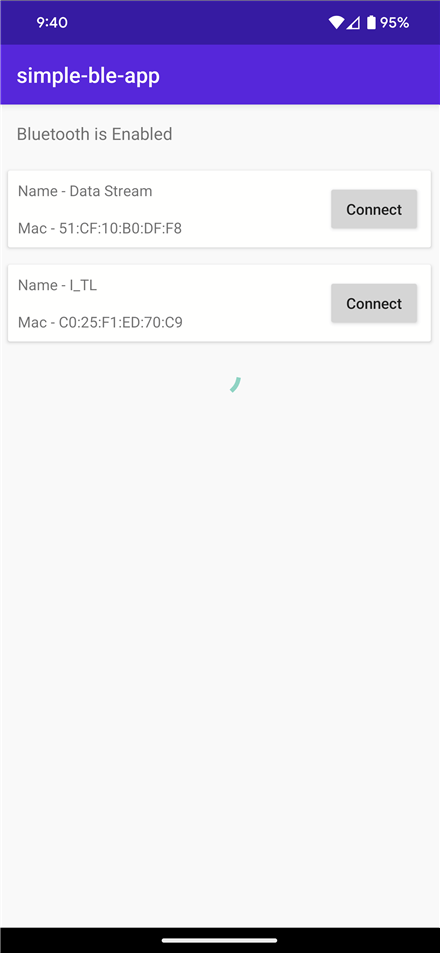

    With  the app, I am able to see the custom project advertising:
    I can then connect
    Afterwards, I can send a single packet successfully it seems

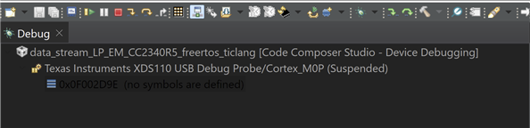

    When sending a burst,  it seems to work for a few seconds, but then hang.
    Pausing execution shows the device here:
    To confirm, is this what you are seeing on your side? I want to confirm we are looking at the same behavior as we continue the debug.
    Jan
    I confirm you that we are aligned with the same issue.
    I have done a bit more debugging and found that the timing of the issue is a bit variable. I have added some print statements that track how many indications have been sent and how many writes have been sent.
    During my testing, I found that the write amount varies. My guess right now is that the BLE5-Stack is getting overwhelmed due to the number of indications and writes. I would like to take some sniffer logs early next week to better understand what is going on over the air.

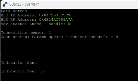

    In burst mode, If I send a notification using BLEAppUtil_invokeFunction when I just receive the WRITE WITHOUT RESPONSE callback then it fails too.
    3. Can you try stopping the indication stream during a GATT write burst? This way at any given moment either indications are being sent or gatt writes, but not both at the same time.
    I have modified the android test app and data stream example with the following way: When CC2340R5 receives a write without response then it sends an indication to the app and when app receives an indication, app sends a write without response to the CC2340R5. With that approach everything is working correctly.
    In this case and from CC2340R5 point of view it is sending indications and receiving gatt writes very fast but not at same time.

    Got it. Agreed that the stack should not be crashing in the way it is under this load. I will continue investigating this on our side to see what can be done beyond reducing the indication frequency. I would be happy to support a call. Please let your TI representative know and we will arrange something for sometime next week.
    In the meantime, can you look for &l2capNumDataPkts in the memory browser and record the number you see before you start transmitting packets, while you are transmitting packets and then after the behavior occurs?
