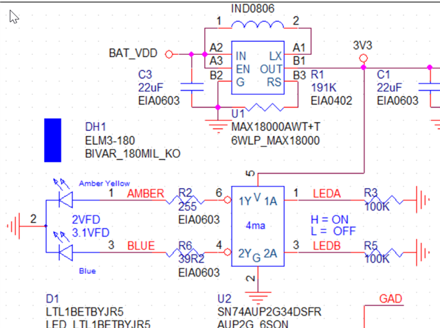

Uning the High Drive pins of CC2340R5 and VBAT (same as VDDS) what current max and the high-drive pins.
I am assuming 2.46V from the CC2340R5 datasheet. If insufficient for my blue led (3.1vfd).
Does TI have a 2 input driver with charge pump to boost from 2V to 3.5V?
