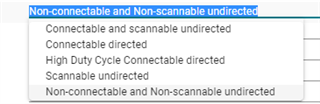

i want to change the advertisement type to non connectable.  PDU type = ADV_NONCONN_IND
i tried to check the option available in the sysconfig menu and here they are :
by default it's set to the first option 'connectable and scannable'
when i change it to 'scannable undirect' i get a PDU Type in the ble analyzer as ADV_SCAN_IND
PDU type binary value :
when i changed the last option 'Non-Connectable and Non-scannable undirect' and run the code i didn't receive anything advertised.
all the other option i selected from the menu didn't gave me the 'PDU type = ADV_NONCONN_IND'

  • i was able to fix the issue.
    I had to change the device role in sysconfig file to Broadcaster instead of peripheral.
    and select non connectable and non scannable undirected under legacy event
    when i changed the device role to Broadcaster i had problem in the sysconfig file :  Error: eventProps: attempted to disable unknown option 'GAP_ADV_PROP_CONNECTABLE'
