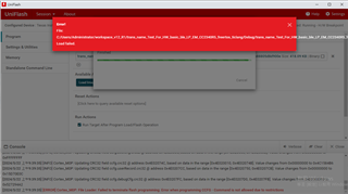

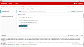

Hi, Evan
Yes, I mean flashing.
Below is the error I'm seeing and my uniflash setup screen, I'm using uniflash version 8.4.0.4458.

Hello Preston,
Can I ask the reason for flashing the device without erasing the flash? Is there a specific region you wish to remain the same?
If you would like to keep the CCFG section intact, you can select Chip Erase (Retain sectors specified in CCFG).
Please read the Non-Volatile Interface section of the user's guide, this will explain that the flash must be erased before re-flashing.
Let me know if you have any more questions!

Hello Preston,
The technical reference manual references chipEraseRetain. This field can be set to retain specific areas of flash when attempting to re-flash the device. Please read sections 8.2.2, 8.2.4.2 and 8.3.2.3 to learn more. Additionally, the field is contained within the hw_ccfg.h file.
Let me know if you have any questions!

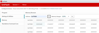

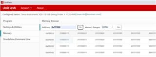

My factory data flash area ranges from 0x7F000 to 0x80000.
First, I write the factory data to the above area by NVS_write().
Then I commented out the code related to operating the nvs and re-flashed.This area is still restored to 0xFF.
My Flash Protection Settings are shown in the image below:
Can I ask if there is a misconfiguration that is causing the sectors not to be reserved? My understanding is that by changing the data in the Erase/Retain, Main Sectors 32-255 option, corresponding to the sector indicator bit to 1, this sector will be protected.
Best Regards
