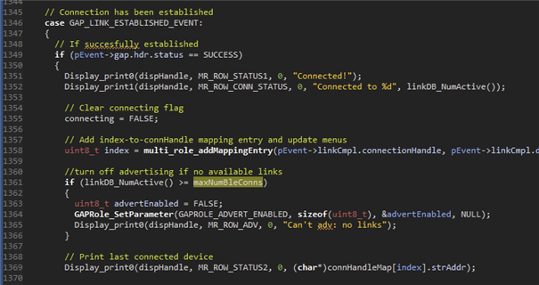

As you said, do you have any references for maintaining device advertising?
An additional problem is that when a peripheral device is connected to two central devices, advertising stops and scanning is not possible.
The multirole example should continue to advertise if the numbmer of connections formed is less than the value specified in the maxNumBleConns vairable. By default, this is equal to MAX_NUM_BLE_CONNS (which resolves to 3). Has this been modified?
Jan
After a connection is established, the following code snippet is what determines if the advertisements should remain on or turn off.
As you can see, this depends on the value of maxNumBleConns and the current number of active connections.
