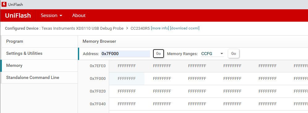

    I used the project you provided for testing.And then I ran into some problems.
    1. When I select Chip Erase (Retain sectors specified in CCFG), I can't re-flash it.
    If I change to selecting Chip Erase with all other conditions unchanged, I can re-flash successfully.
    2. I also tried re-flashing using J-link, and looking through the tool it doesn't write or erase 0x7F000-0x80000, but the contents of 0x7F000-0x80000 still  0xFF. What is the reason for this? If I want to enable the flash protection can I use J-link?

    We had two models of cc2340 (CC2340R5 and CC2340R5 Q1) and then did the relevant verification
    CC2340R5(demo board):
    1.Re-flashing with ccs allows normal use of flash protection
    2.Re-flashing with uniflash allows normal use of flash protection
    3.Flash protection failure after re-flash with J-link(Using J-Flash V7.92o, deselect 0x7F000-0x7FFFF, deselect means J-link does not erase unselected area)
    CC2340R5-Q1(Self-developed boards):
    2.Memory cannot be reflashed by selecting Chip Erase (Retain sectors specified in CCFG).
    Are there any differences between CC2340R5 and CC2340R5-Q1 when reflashing memory using uniflash?

    Still can't re-flash on uniflash after change pin configuration.
    May I ask what file extension you re-flashed? I tried .out, .hex(ASCII hex), .bin.
    Also since it's a Self-developed boards,we connect TCK, TMS and GND to the XDS110 with DuPont wires.Does this satisfy the hardware re-flash condition?

    I'm using an external power supply, and the connections to the XDS-110 are SWDIO (TMS), SWDCK (TCK), and GND. The flash memory can be re-flashed properly using CCS and the flash protection works properly.
    What is the difference between using CCS and uniflash? Is it possible to have problems with CRC checksums and such? I'll have the hardware check it out, too.
    Also, can you tell me why the Jlink debugger doesn't support it? Thanks !
    Best Regards
    Preston
    Newsflash, I found a way to reflash, I need to hold down the reset button, click on “Load Image” and then let go and it will download!

  • Hello Preston,
    Glad to hear you were able to flash the board!
    TI supports the use of J-Link debuggers, but some features are not available. I am not sure if this is something that will be added in the future, but I will check.
    I am not sure why holding the reset button allowed Uniflash to flash the image. I recommend having the custom design reviewed for possible issues in general and with the reset line. Be sure to let the hardware team know about the behavior associated with the reset line and flashing on Uniflash.
    There is no difference in the way CCS and Uniflash flash the software image.
    Yes, please create another E2E thread for the new question.
