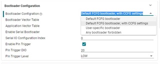

  • Hi, Achyut:
    Thanks for you reply.
    I can find this source code, what I want to express is that the HEX file I compiled with this source code is not the same as the HEX file provided by TI in hexfiles to run the result, have you changed the source code, can you give us a reference?
    Also, in the Bootloader Configration option above picture, these settings are valid for other apps, but not for mcuboot, This means that every time before MCUBOOT is run, the rom boot is run first, so how do I set it up to only run MCUBOOT and not the rom boot?
