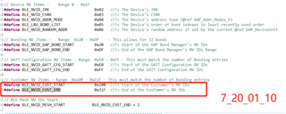

In SDK version 7_20_01_10 the NVID range for customer is from 0x100 to 0x11F

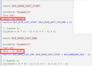

But in the newest SDK 8_10_00_55 the ID range is 0x67~0x71,

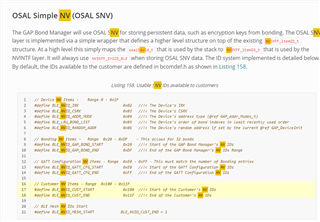

in document it say ID range 0x100~ 0x11F
So I am curios about which rule should I follow?
