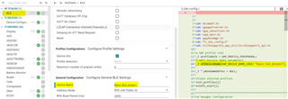

We are using the BLE5 example project "Data Stream". I would like to adapt it to our requirements. It is working well so far. When switching on or initializing, i.e. during runtime, I would like to change the device name from "Data Stream" to, for example, "Hello 1001". I would like each BLE device to have its own name and number. How can I do this? It would be ideal if you could show me the place in the project or have an example code that fits the "Data Stream" project.
  • Hello Ali,
    Thanks for reaching out.
    So, if you want to change the device advertisement name, you can do it through SysConfig as shown in the image below.
    If you need to modify this during runtime, you can see that the name is being stored in "attDeviceName" variable which is part of the parameters stored in appMainParams (of type BLEAppUtil_GeneralParams_t ). You can see this definition in app_main.c
    Please make sure the name is no longer than GAP_DEVICE_NAME_LEN, which is 21 characters.
    BR,
    David.
