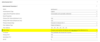

CC2340R5 configured as peripheral would need to connect it to only one dedicated central (I'm currently using my android phone as central).
I'm exploring ways to prevent the CC2340R5 from connecting to other centrals.

    You can use the accept list, in SysConfig localize "Filter Policy" under Advertisement Parameters
    You can add device address to the Accept list with the HCI_LE_AddAcceptListCmd command.
    I hope it will help,
    Tanguy
    Still not working.
    I Also reversed the byte order of the BLE address.
    Using stack version : f3  74_40_00_64
    Oren
