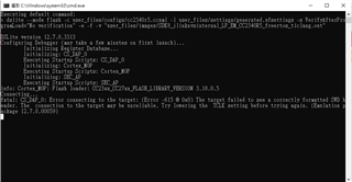

Hi, Evan
I failed to download it. Do I need to connect the reset pin when I reflash Self-developed board? I currently only have SWDIO (TMS), SWDCK (TCK), GND connected to the XDS110, and 3.3V externally powered.
From the error it looks like it can't get into download mode.

Preston,
First, it would be recommended that you test to make sure your CLI arguments work with a standard TI CC2340R5 LaunchPad. Can you check this first?
But generally, yes it is highly recommended that you have the reset pin. After you reflash, the programmer will attempt to invoke a reset. You can view the programming flow here under Section 8.2.4.
Hi, Evan
I connected the CC2340 reset pin to the XDS110, and I can reflash CC2340 after connecting it.
