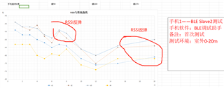

1.The customer is using CC2340R5 to make a Bluetooth car key. The ranging solution is based on the signal strength RSSI value. Currently, the customer is testing outdoor and communicating with mobile phone BLE. The signal strength received by CC2340 increases with the distance. In theory, the signal should become smaller and smaller. , the actual test distance is far away and there is an increase in some areas. What is the cause of this? . For example, is there RSSI automatic gain adjustment inside the chip, or is it affected by other factors?

    Unless the customer is testing this on an anechoic chamber, which isolates the radios from external influences, it is very difficult to pinpoint an exact reason why the signal is reaching the receiver with different intensities depending on a single variable such as the linear distance between the two nodes.
    Among the various external influences are signal reflections, which can increase or decrease the signal intensity depending on its travelled path. Also, destructive interference from other signal sources can decrease the receiver's RSSI depending on the location of each node. One additional aspect that might also influence the performance is how the car key (receiver) is being held - its internal antenna can be influenced by the hand.
