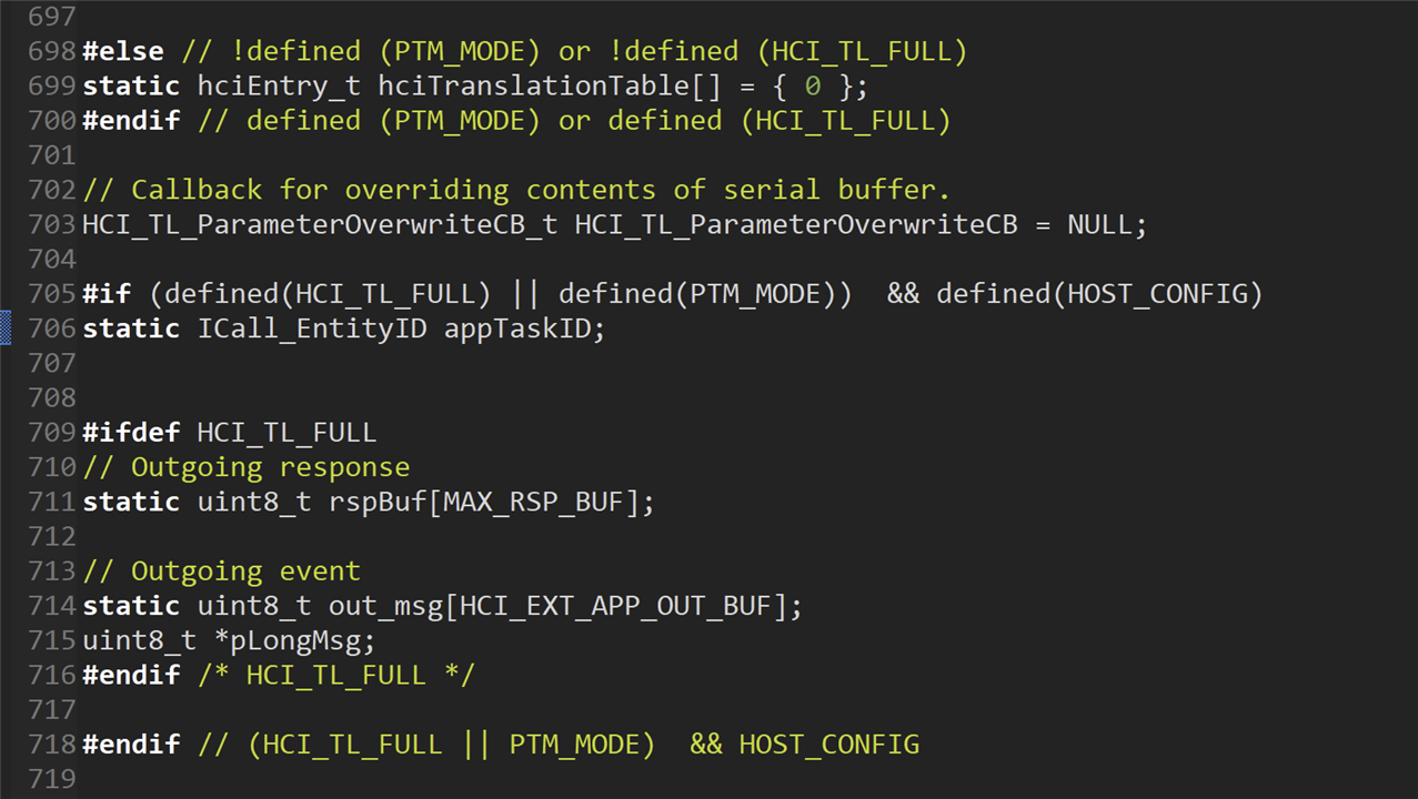

There is a compile error when I enable both PTM and L2cap CoC for simple_peripheral example. (sdk version: sdk_7_10_01_24)
Could you help with this issue? Thank you!
C:/ti/simplelink_cc13xx_cc26xx_sdk_7_10_01_24/source/ti/ble5stack/icall/app/icall_hci_tl.c:9010:12: warning: call to undeclared function 'buildHCIExtHeader'; ISO C99 and later do not support implicit function declarations [-Wimplicit-function-declaration]
msgLen = buildHCIExtHeader(out_msg, (HCI_EXT_L2CAP_EVENT | L2CAP_CONNECT_IND),
C:/ti/simplelink_cc13xx_cc26xx_sdk_7_10_01_24/source/ti/ble5stack/icall/app/icall_hci_tl.c:9010:30: error: use of undeclared identifier 'out_msg'
C:/ti/simplelink_cc13xx_cc26xx_sdk_7_10_01_24/source/ti/ble5stack/icall/app/icall_hci_tl.c:9013:3: error: use of undeclared identifier 'out_msg'
out_msg[msgLen++] = id;
C:/ti/simplelink_cc13xx_cc26xx_sdk_7_10_01_24/source/ti/ble5stack/icall/app/icall_hci_tl.c:9014:36: error: use of undeclared identifier 'out_msg'
msgLen += L2CAP_BuildConnectReq(&out_msg[msgLen], (uint8_t *)pReq);
C:/ti/simplelink_cc13xx_cc26xx_sdk_7_10_01_24/source/ti/ble5stack/icall/app/icall_hci_tl.c:9017:61: error: use of undeclared identifier 'out_msg'
HCI_SendControllerToHostEvent(HCI_VE_EVENT_CODE, msgLen, out_msg);
    Thank you for reaching out. Can you share how you are enabling PTM and L2CAP on your project?

    The steps to reproduce this issue are as follows:
    1. import ccs project C:\ti\simplelink_cc13xx_cc26xx_sdk_7_10_01_24\examples\rtos\CC26X2R1_LAUNCHXL\ble5stack\simple_peripheral
    2. enable "BLE->BLE Features-> L2CAP Connection Oriented Channels" and "BLE->Advanced Settings->PTM" in simple_peripheral.syscfg
    3. rebuild
    Got it. i was able to reproduce the issue. It seems the behavior only occurs if both PTM and L2CAP are enabled. I believe the problematic line is line 714 in icall_hci_tl.c
    Can you try moving line 714 outside of the #ifdef? You can do this without modifying your SDK installation, by deleting the linked file for icall_hci_tl.c found in iCallBLE and replacing it with a local copy (by dragging and dropping the SDK copy to the iCallBLE folder in CCS and clicking on copy).

  • Hi Jan,
    It works. Thank you!
