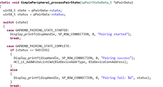

    Jan
    My sincerest apologies for the extended delay. I was able to implement the allow-list filtering on my side. I added a few modifiactions to the simple_peripheral project to enable this functionality. First, I removed the long range advertising set and am only using a single one. This means I removed all references to advHandleLongRange. Afterwards, I limited the amount of connections to 1 connection (to cause the device to stop advertising after one connection).
    When the connection is established, I add the device to the allow list
    After the connection is established, I would read Characteristic 5 to initiate pairing. In the pairing callback, I added code to change the allow list policy. I did it in this location because the advertisements should be off by this point:
    Using this project, I was able to connect to the CC26X2R1 device using an Android device, pair, disconnect & reconnect repeatedly, and when attempting to connect with another device it would never allow a connection to form.
    I have uploaded the project here: 1512.simple_peripheral_CC26X2R1_LAUNCHXL_tirtos7_ticlang.zip
    Can you try it on your side? Again, i apologize for the delay in providing these code snippets.

    2. You are using the HCI custom API to add devices to the whitelist
    I would assume the gapbondmgr component should take care of it and from the TI guide it not recommended to handle this in the application. Furthermore, if this is handled in the application, then one must also take care of the LRU bond list handling I believe. Is it intentional that we need to do it explicitly in the new SDK?
    Could you please amend the your example application with two adv sets and try to reproduce the scenario I described. The setting for adv sets are described here: https://e2e.ti.com/support/wireless-connectivity/bluetooth-group/bluetooth/f/bluetooth-forum/1373648/cc2651r3-previously-bonded-devices-can-not-connect-in-whitelist-mode/5253981#5253981

  • Hi Kaiwalya,
    To clarify, I changed the filter setting to only allow connections from devices in the whitelist after the pairing event has been received. Essentially converting my advertising set from advSet2 to advSet1.
    As a quick test, can you try using the HCI commands on your side to see if that works?

  • Hi Jan,
    I tried using the HCI API to add the device (which is paired) manually to the whitelist.
    However, I am not able to connect in whitelist adv for subsequent connections (tested both on iOS and Android)
