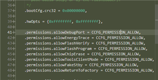

I have set the following CCFG settings, but I cannot access the debug.
 CCFG.permissions.allowDebugPort=CCFG_PERMISSION_ALLOW
 CCFG.debugCfg.authorization=CCFG_DBGAUTH_DBGOPEN (no debug authentication required)
Please let me know if there are any other necessary settings to connect to SWD.

    I hope you are doing well! Is this a custom board, or a LauchPad? Are you using CCS? Could you provide the details of your "ti_devices_config.c" file?

    We are a debug tool vendor, and the board with the debug access issue belongs to an end user. Therefore, we do not have any additional information beyond what I have already shared. I apologize for this. However, it is likely a custom board. The system is functioning correctly, except for the inability to access debug via SWD.
    If there are any additional settings related to debug access in the config file that we should be aware of, could you please let us know?
    Thank you for your assistance.
    To give a little bit of background on the "ti_devices_config.c", and information useful in it:
    We can find the state of the device based off of line 41-48, for example if the device has debug allowed, among many other settings.
    We also have the debug password (use with UniFlash) on line 78/79 which is important if we want to access a debug locked device:
