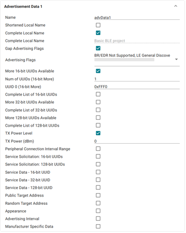

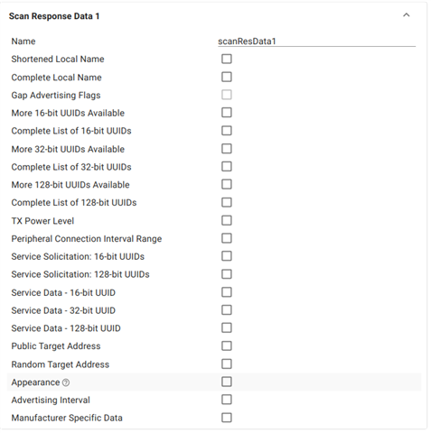

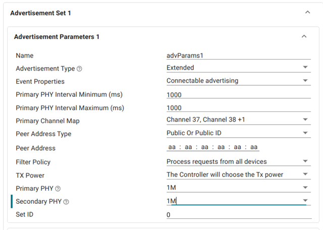

    - could you please share a screen shot of the SysConfig configuration for the advertisement?
    - could you try changing the primary and secondary PHYs used? (try using 1M PHY only)
  • Hi Clement,
    Yes, I configured the primary and secondary PHYs for advertising as using 1M only. Please check my advertisement configuration from below screen shot:

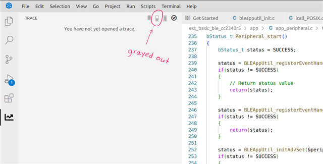

    The instructions I found in web pages for how to use the EnergyTrace are for CCS. But my CCS Theia menu layout is very different. At the end, I found the EnergyTrace button in a location of my CCS Theia shown in below screenshot. Please firstly have a check.
    But, as you can see, the EnergyTrace button is grayed out.  Please help me in how to use this tool. Thanks!
    Kr,
    woody
  • Hi Woody,
    Sorry for the delay. Please see this guide on how to use the Energy Trace Tool on CCS Theia Energy Trace Tool CCS Theia which has a section on how to start the energy trace. Also, you need to be on debug session to run the energy trace.
