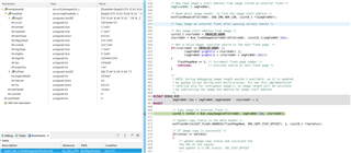

I think I am almost there. I use my external memory to receive my OAD image.
The image is received, CRC calculated OK, everything seems to work fine.
However, my BIM does not seem able to boot such properly downloaded image. Please see the following screenshot with debugger watched variables.
As you can see, it checks OK all conditions.
Do you see something that immediately appears as wrong?
I checked the len of the image and is exaclty 293668 so it is ok.
Maybe flashPageNum or imgFxdHdr->prgEntry?
Please let me know any suggestion and have a nice day.
  • Hi kazola,
    The BIM and App SPI pins needs to be the same if you are using custom board.
    -kel

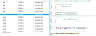

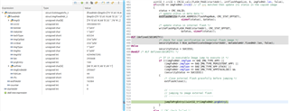

    The following screenshot shows you it seems to match. Please notice how the BIM managed to do most of the job OK.
    Even the retval of the highligted line returns 0, so success.
    The next call to extFlashWrite, even if not controlled, returns True, so success.
    Please see in the following one, it even goes down to jumping.
    I also used the debugger to do what you asked.
    Please see for example vectorTable[8] seems to be the typical 0001 OAD version.

    PS: as an additional check, I sent via the Simplelink Connect App a modified version of the image I am sending, with the softVer set to 0,0,0,9 instead of the default 0,0,0,1. This was meant to allow us to see if the BIM is seeing the sent image. Please check in the following screenshot this is the case.
