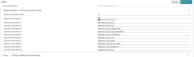

  • I have tested the multi_role example in ble it's work fine Every function return success.
    I think an issue with the dmm
    The image above is the dmm property in syscnfg , I think issue with it , is there any example with zigbee and ble (peripheral + observer) in dmm so That i can update my code.?

  • Hello Pavan,
    If you have not already, we have a good DMM guide within the SDK TI DMM User's Guide.
    We have a similar e2e (this one with Thread + dmm instead of ZigBee) and the answer is that currently we do not have any available official examples, so the best process is to reference our SLAs/SDK on the integration:
    https://e2e.ti.com/f/1/t/1322357/
