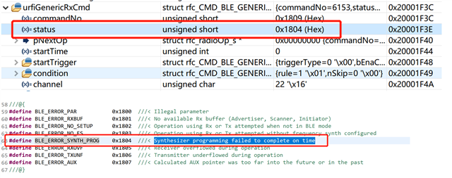

Hi:
connection monitor develop by CC2642.
call function RF_postCmd,but urfiGenericRxCmd.status is 0x1804.once this problem is encountered, it can no longer be restored under constant power,what kind of question is that?is there any way to restore without a power outage and restart?
SDK:simplelink_cc13xx_cc26xx_sdk_7_10_02_23
