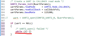

    I apologize for my delayed response; I am currently on vacation until next Monday. Regarding the issue, I have tried turning off the UART and adding sleep to the task, but the power consumption remains unchanged. I can't think of any other ways to reduce it.
    //uart = UART2_open(CONFIG_UART2_0, &uartParams);

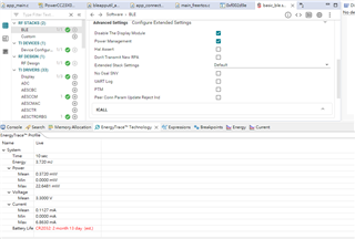

    No worries! Can you share what is the base example you are working off? Is this a BLE example? If so, then can you disable the display within the sysconfig settings? This is found inside the BLE module. Also, can you share how you are measuring the power draw? Could you share a picture of the setup? Enjoy your vacation! :)
    Jan
  • Hi jan,
    I'm doing some research based on basic_ble_LP_EM_CC2340R5_freertos_ticlang. I seem to have found my issue: I disabled the UART, but I didn't comment out the contents inside if (uart == NULL). After making this change, the power consumption has improved, but it still feels a bit high (original advertising consumption: 6μA; after adding Task: 120μA). I've already disabled the LED and UART and added sleep(). It seems that executing Tasks during broadcasting is not very suitable? Maybe I'm wrong. If you could provide some reference code, that would be great! Previously, when using the MSP430 MCU, it could enter low power mode and exit low power mode. I wonder if the CC2340R5 has similar features?

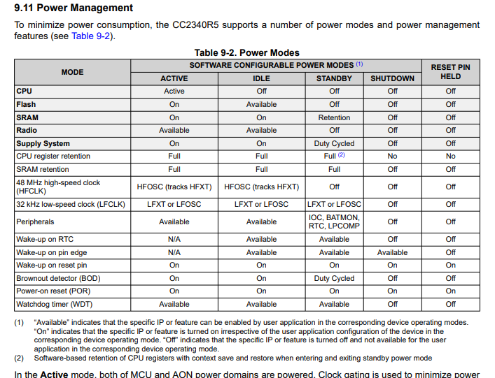

    Agreed that the 120uA figure is very high if you are not intending to do anything in the separate task. Can you share the latest code of the separate task to make sure we haven't missed anything?
    The CC2340R5 uses the Power Manager to change the power state of the device during runtime. The Power Manager will automatically place the device in the lowest possible power state when all tasks have yielded. The lowest possible power state will depend on the peripherals being used at a given time. The following table from the datasheet details which power levels are achievable based on the peripherals that are active:
