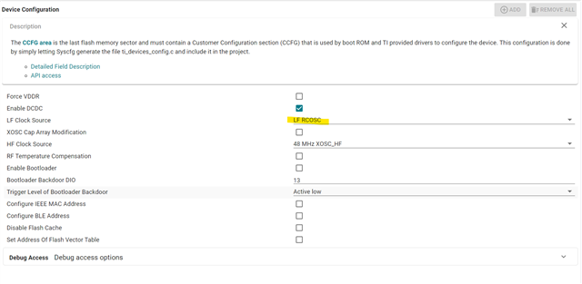

migrating SDK from 7.10.2.23 to 7.41.0.17 we discovered an issue.
Using SysConfig 1.20.0 configuring RCOSC as LF clock source:
USE_RCOSC is not defined in /syscfg/ti_utils_build_compiler.opt
In earlier versions of the SDK it was defined in deprecated syscfg/ti_ble_app_config.opt
