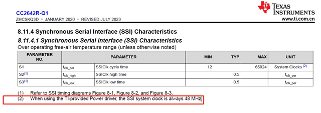

What is the speed of CC2642's SPI bus? I see in the specification that it is 4M, and the clock frequency is 48M. The demo is set to 12M. Please help confirm it.
Thank you very much!

Hi Arabella,
The SSI system clock is the source from which the SPI clock is derived, but does not insinuate 48 MHz bit rate capabilities in of itself. The SPICC26X2DMA TI Driver defines the maximum bit rates as such:
When the SPI is configured as SPI peripheral, the maximum bit rate is 4MHz.
When the SPI is configured as SPI controller, the maximum bit rate is 12MHz.
The spicontroller example uses 1 MHz as the default. 4 MHz for either the controller or peripheral modes is acceptable and recommended, as the bit rate is configurable in the SPI application code. I'm not sure what demo you're referring to in which 12 MHz is set.
