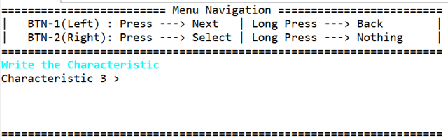

Background
I am using two LP-EM-CC2340R5 evaluation boards for communication.
If I write 01 to Characteristic3, 01 is notified to Characteristic4.
Connect the Central device to the Terminal. Refer to the Write the Characteristic menu.By selecting Characteristic3, 01 is sent.
Therefore, if you do not select Characteristic3, 01 will not be sent.
Question
How can I send 01 continuously with Characteristic3?
Specifically, I want to send 01 with Characteristic3 every 50ms.
