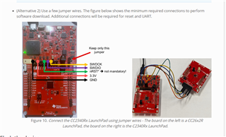

Hello.
I created software using LP-EM-CC2340R5 and LP-XDS110ET.
Next, I plan to make a small board and connect it to the LP-XDS110ET via SWD for debugging.
I plan to connect the following signals from the 20-pin connector of the LP-XDS110ET.
3V3
GND
SWDCK
SWDIO
LP_RESET
I would also like to measure current with EnergyTrace, but are there any other signals that are required?
Also, is LP_RESET unnecessary if I never press the reset button on the LP-XDS110ET?
