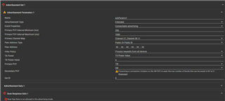

  • Hello Xuefeng.jin,
    Just to preface I am not as experienced on BLE stack as I am with proprf however I should be able to help guide through the initial steps:
    Could you check your broadcaster configuration in syscfg? There is a field for the PHY setting here which is a little different from what I recommended above.
    To enable 2M PHY we would need to change the advertisement type from "legacy" to "extended" and set the secondary PHY to 2M (the only option for Primary PHY is 1M it seems).
    Alex F
  • Hi Alex,
    Thank you for explain. when change this to extend, have bellow questions.
    1. When use extended mode, scan response is not allowed. but i have some manual modify in this part.
    2. And this primary PHY don't have 2M. so it can't only keep 2M.
    3. This part is advertisement, but what I care is just after connection data transfer.
